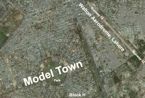

Following image shows Runway 14 and Runway 32 of Walton Aerodrome, Model Town, Model Town Park and Block H of Model Town where AP-BCS crashed into a house.
Seems AP-BCS was going to land on Runway 32 of Walton Aerodrome. The other side/direction of this runway is numbered as Runway 14.Report fails to find cause behind plane crash

Abbas Ali wrote:Four days old news report:
Looks like you flipped the runways around Abbas. Runway 32 should be top and 14 on the bottom in that picture you posted so in that case they were heading for runway 32 in fact it looks as if they were on a extended right base for 32.

Re: Hybrid Aviation Cessna Crashes in Lahore
This is correctly labelled. Just shows how familiar you are with Walton.Looks like you flipped the runways around Abbas. Runway 32 should be top and 14 on the bottom in that picture you posted so in that case they were heading for runway 32 in fact it looks as if they were on a extended right base for 32.

=D>
Not familiar at all actually I have never gotten the chance to fly there but you don't need to be familiar with the airport to know what the runways will look like in this case it was my mistake because It looked similar to one of the airports I operate in and that is called Stinson which has the same runways but I kinda forgot that we approach from the North for it thats why the 14 seemed to be in the opposite direction. Hate to be proven wrong but you got me.
Check Stinson Municipal Airport in Texas.
