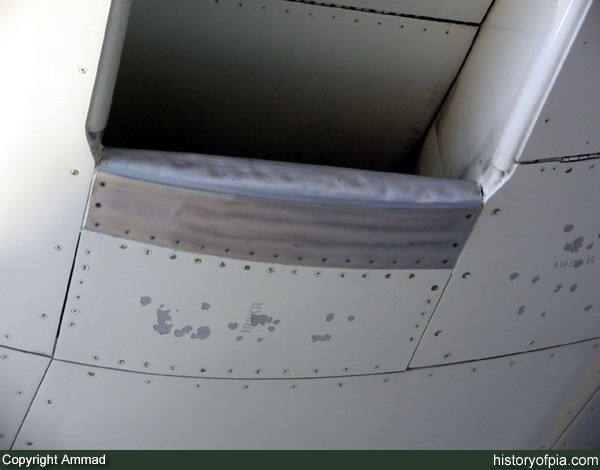

The aircraft’s nose radome, which houses the weather radar, was badly damaged, the pressurisation system packs inlet totally destroyed and leading edge flaps on both wings severely dented. There are other perforations, dents on the fuselage and major rivets undone. Both the outer panes of the cockpit front windshields were broken, impairing visibility of both pilots.

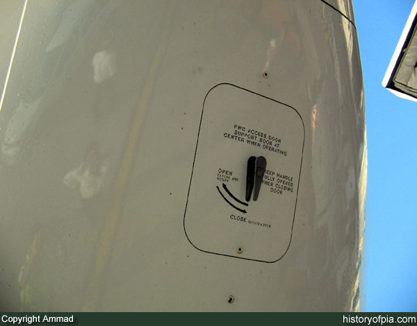

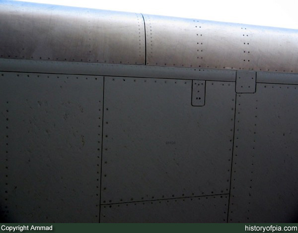

Some more photos of damaged PIA Boeing 777-240ER (AP-BHX) sent by forum member Ammad.
Thank you Ammad for sharing.
