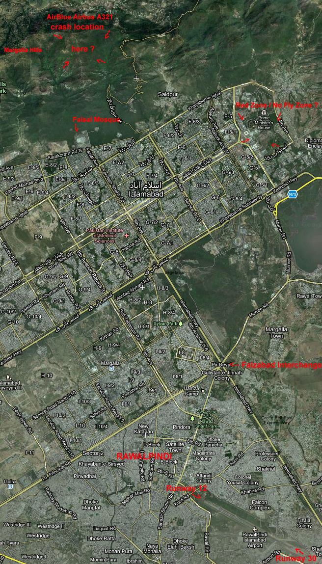

But dont forget on other side of Faisal Mosque(west i believe)We've got Air and Navy headquarters,,so does this RED zone starts from Parliament house to all the way to Air headquarters or they have two separate red zones.??Moin wrote:Abbas, if the location of the crash as pointed out by you on the map above is correct, I don't think its possible that the plane went anywhere close to the red zone. That is way off towards the East. It would be extremely bizarre that the plane would veer so far off course all the way to the East because it would first have made a turn to the right, fly towards the red zone and then turn left and head straight for the hills. There are witnesses in F7 who claim to have heard and even seen the plane fly over the area. Based on that those claims, it seems improbable that the plane was coming from the East/Red Zone area. Based on the above map, I think the plane flew straight ahead after leaving the airport and executed a very slow right turn if it ended up at the crash site as shown on the map.
Either way, the only version I'm inclined to believe will be the official version from Airbus and no one else.

That is what I was also thinking. Abbas has only shown the red zone to the East. Is there another one to the West? So far there is only talk of one red zone so I based my assumption on there being only that.

I have a few years old video made from a PIA Fokker F-27 operating flight from Islamabad to Gilgit and in that video Faisal Mosque is viewed from aircraft's left side as it moves forward to fly over Margalla Hills. I've added location of Faisal Mosque in following image.
So, I think the point (if it's correctly shown in following image) where AirBlue A321 crashed into Margalla Hills was not a 'no fly zone'.

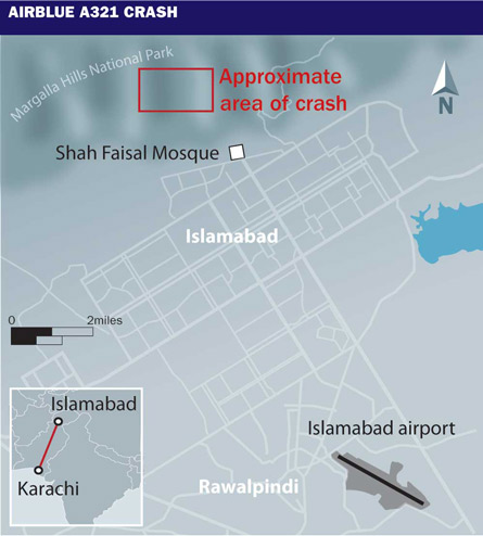

Here's related info on Flight Global website:
AbbasDetails emerge about fatal flight path of Pakistani Airblue A321
By Leithen Francis
The Airblue passenger aircraft that crashed yesterday in Pakistan was doing a circling approach to runway 12 at Islamabad's Benazir Bhutto International Airport because it was prevented from landing at runway 30 due to adverse winds.
"The aircraft was on an ILS (instrument landing system) approach to runway 30 from the southeast and then broke off due to adverse winds and started to do a circling visual approach for runway 12 from the northwest side," Airblue CEO, Shahid Khaqan Abbasi, says in an email to ATI.
"The crash site is actually north/northeast of the airport on an extended downward wind," he adds.
The crash site is in the Margalla mountains and satellite images show the crash site is 9.66nm from the airport.
Air traffic control prevented the aircraft from landing on runway 30 because the aircraft would have encountered a tail-wind if it tried to land on that runway, says a Karachi-based official, who wishes to remain anonymous. The official works in the Pakistan CAA's air traffic control management division.
The official also says aircraft doing a circling approach into Islamabad airport are required to stay within 5nm of the airport. The fact that the crash site is more than 5nm away means the aircraft was in a no-fly zone, he adds.
Source: www.flightglobal.com
