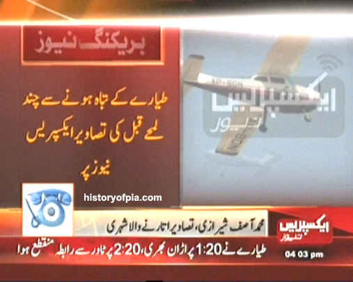

It seems, news channels in their breaking news/alerts race, sometimes air information and photos without getting them verified from relevant authorities.
Here's an example: Yesterday, Express News channel was airing photos sent to them by someone claiming that photos showed the ill-fated aircraft few moments before it crashed. However, these photos showed Hybrid Aviation Cessna 172N Skyhawk with aircraft registration AP-BDN clearly visible.
The crashed aircraft was Hybrid Aviation Cessna 150D (registration AP-BCS) as seen in following image taken from video footage also aired by Express News channel before it displayed photos of AP-BDN.
